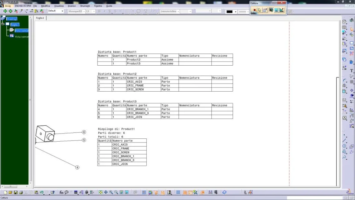

but do you do it with the sceneries? Can't you import the explosion scenario in 2d? What's the problem?
when you do the distinct base of the overall, by default it also calls you subsets, how can you not? send an example of what comes out of you.. .
we start from the distinct:
if you want to customize the distinct entries, just log a macro with the preferred setting and then execute it, that is:
instruments/macro/start recording
then menu/analysis/basic/define formats (view the properties you need and then the reorders in the list, when you're done by ok)
interrupt recording
the custom macro call it bom_client_pippo and execute it when you need the separate to pop.. .
1.webpthe table returns you tables with the properties displayed, you use them or gates
