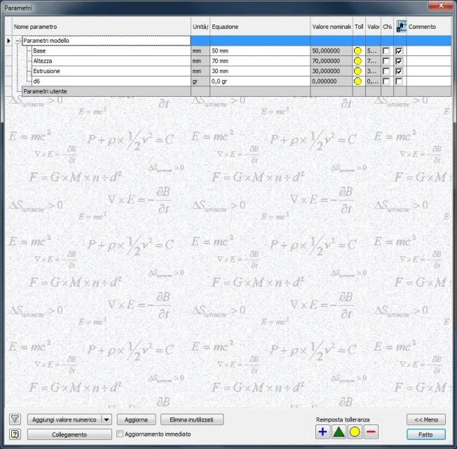

Here, I was wrong:redface:you're in the parameters window, pick up the "export parameter" column that I imagine you've already done. at this point go to the value to the column "Nominal value" of the parameter itself, dx key and "Formed custom property". from there impose various settings of how you want the value to be exported.

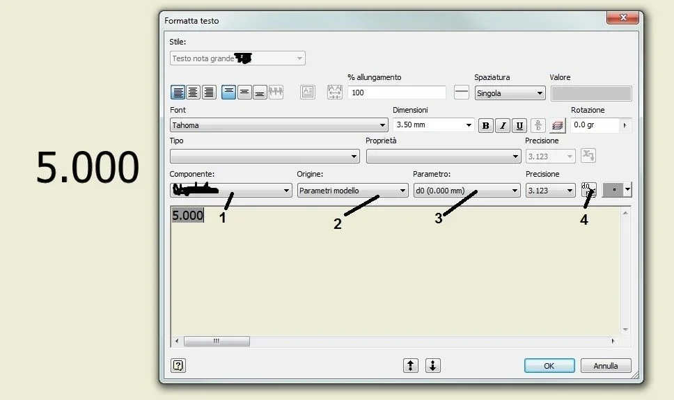

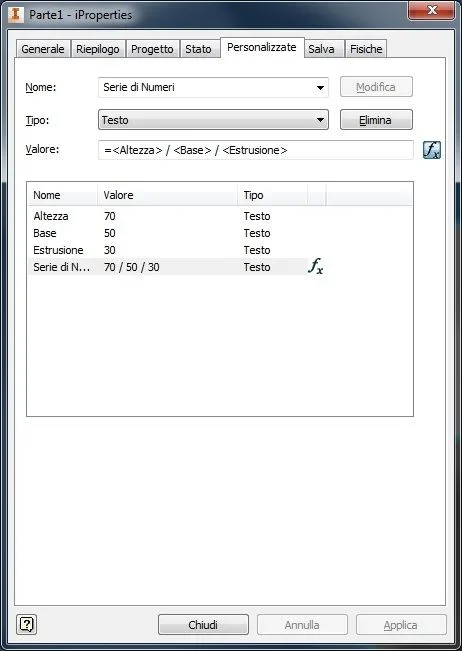

I didn't understand the column thing with two varietals. And the number series I imagine you need in iproperties, right?Yes that I know, the problem and that I can't enter into the same row more values, that works on the single parameter, I must have a set of numbers divided by one / and all without unit of measurement.
and if you try to set what you say a column where 2 variables are wrong to you.
Is there nothing to do with ilogic?? any expert on this matter? ? ?
