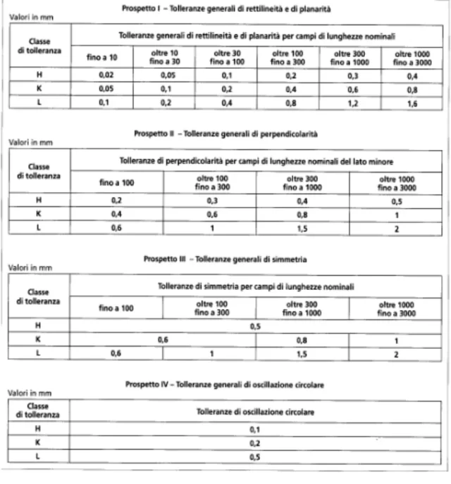

I would like to know what size refers to in the table uni en iso 22768-2 values up to....; from... to ...?
in the uni en iso 22768-1 refer to the dimensional quotas but here dealing surfaces (for example flatness) should I refer to the greater dimensional quota?
Just look. I attach uni en iso 22768-2 referring to geometric tolerances.

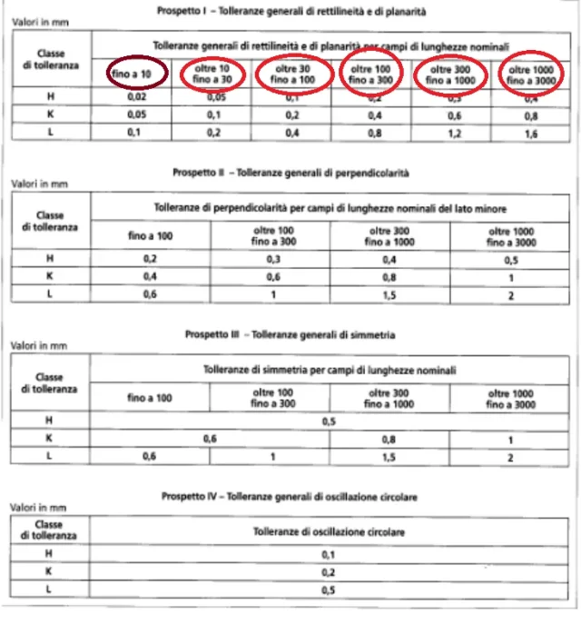

I thank you but my question was: the values under circles to what do they refer to?
If I refer to the uni en iso 22768-mk for a rectangular surface of 10*50 my flatness will be 0.05 or 0.2?
Sorry yesterday I had prepared an image but I didn't attach it.
I refer to the circled values. excuse the misunderstandingView attachment 40151
refer in this case each to its length quota. if a plan is 1500 mm long will have the corresponding tolerance of straightness in that sense and if in the other sense it is 400 will have its value
