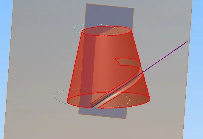

Actually more than a thread should draw a profile that wraps around a conical trunk surface, can anyone help me?
I have designed the development of the propeller to wrap around the cone, but I fear that it is necessary to calculate the length of the development itself... What is absolutely not trivial?
I'm not sure to give you good advice, but there are also equation sketch curves: Maybe seen the additional cone trunk casino work better. . .
I have done countless tests, on the cylinder works egregiously, when I repeat the same operation on the cone trunk is as if it goes mad, it no longer respects me the angle of the propeller.
as soon as I can attach the file
Unfortunately, I am mistaken, says that version 17 is more recent than 16, perhaps because I have inventor 2012 :
tronco di cono.webpThat's what I'm trying to do... the profile does not wrap me up to the top...
No, it's 2013, ciccia... You need this, right? is done with a 3d sketch - equation curve, I don't know if in 2012 there is... I'll tell you in detail how I did it. . .
can't you save in compatibility with the 2012 version? If not tell me what commands you used. . .
no, you can't save in previous versions. . .
as I told you I went on sketch 3d and there I used the curved command from equation: in 2012 this command was already present (in 2011 I don't think so... )
Perhaps we speak of the same command, in my inventor 2012 (in English) I managed to solve with the helical curve command, in which I managed to give the "conicity" to the propeller using the taper option (which is to indicate the semi opening angle of the cone).
