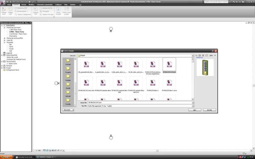

Something strange happens to me...:cool:
in r10 with xp36 pro, updated to the second relaise, I do not see the miniatures neither of the families nor of the projects.(see attachment)
while in explorer as a preview I see everything. .
the beautiful is that with view64pro works.....
But it only happens to me?
