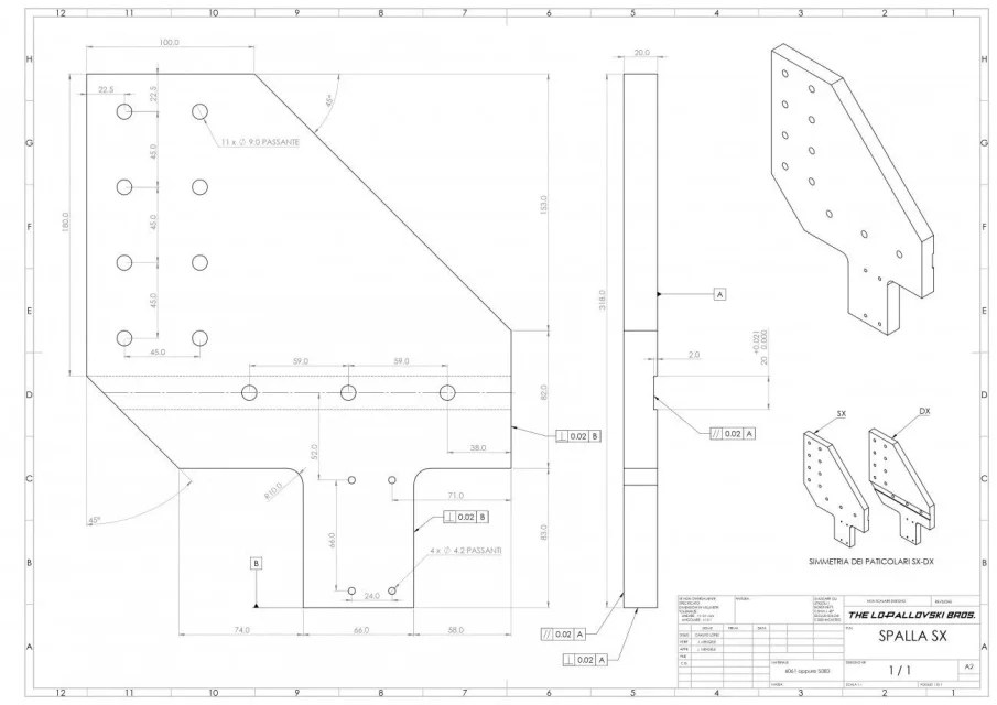

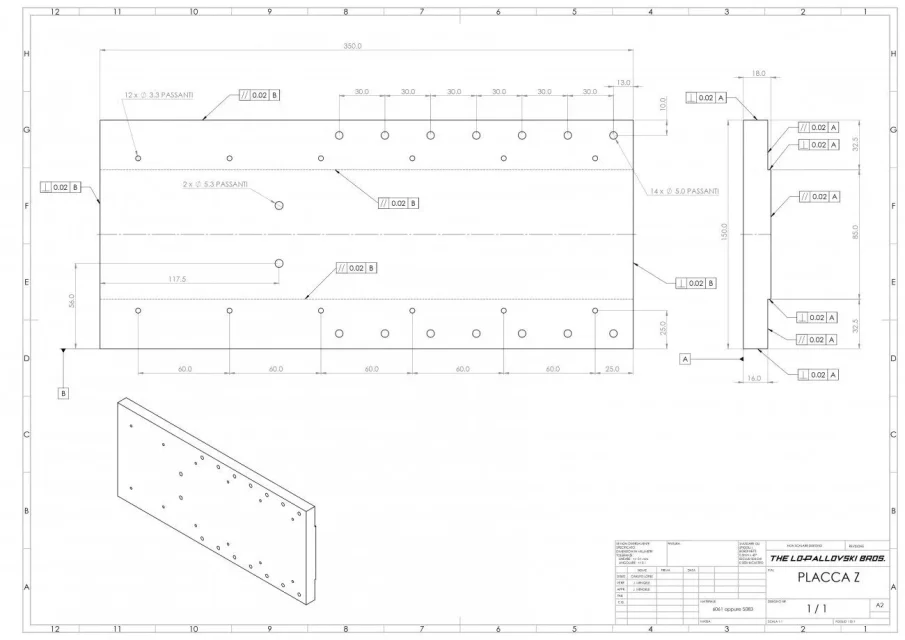

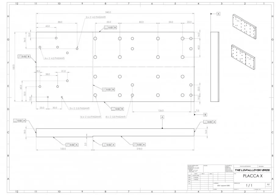

for the pieces "shoulder" I have designed alternatives that are plates, without the "strange" form, since for those pieces I need only parallelism between the main planes, the groove seat for ink that is in the picture, and then a border only in squadron with the planes and the groove (which then I use to control the alignments); that "strange" profile only serves to free space of space, and we can go with the tape saw in the lab.
about tolerances.
I need the planes to be parallel, and the edges to be squared between them and the planes, so that the assembly can be easily put into geometry. instead the holes are deliberately wide enough, so that there is room to adjust in assembly. there are grooves for reference pins of skates and guides, and the pieces "shoulder" and "often skates y" are framed in the seat, with a very light game so that the thickness can flow in during the assembly.
In fact I did not calculate the really necessary tolerances, it would suffice me the tolerance obtained from the machine (if it is in geometry, in good state, all executed correctly). in the past the same pieces I made them with a Chinese vertical cutter with swallow tail guides made cnc and I was more than satisfied.
Here I inserted geometric tolerances of 0.02 everywhere on a friend's advice. 5 cents would definitely be fine.
if you have advice on how to improve the table, change tolerances, to whom to address us, etc., I would be grateful.

see image.
However all those tolerances involve a lot of processing even to make the thickness from 15 or 18.

I get it. I looked at the guidebook, it does not require perpendicularity for shoulders. Perhaps as you say, just touch a clove (and not all the surface of 1.5mm) for positioning (then you tighten the screws and you should not move, except collisions).
for the precision and precarious class of guides we mount, the admissible resting of mounting surfaces (for a distance of 500mm interasse):
- 25 thousandths of parallelism;
- 13 cents of height shock.
So I thought we had to stay with two cents. a friend then told me that normally they expect 3 cents of drawing for the pieces they usually do, without asking for metrological reports and they are well. I do not remember that tolerances are obtained from a good working center, in geometry and in good state, with tools and placements performed well. I remembered that on pieces less than this size, 5-3 cents was not a problem.
Of course, it's not a problem, but tolerances must be put where they need and not "so the machine respects them without problems"
for example on all side surfaces that do not mate (see examples in images) what do they serve? Nothing. What do you mean? No. Does the processing price raise you? Yes.
parallelism between faces is indispensable; the edges are indispensable to be in squadron because I use them as a reference when I go to mount. Unfortunately, everyone.
