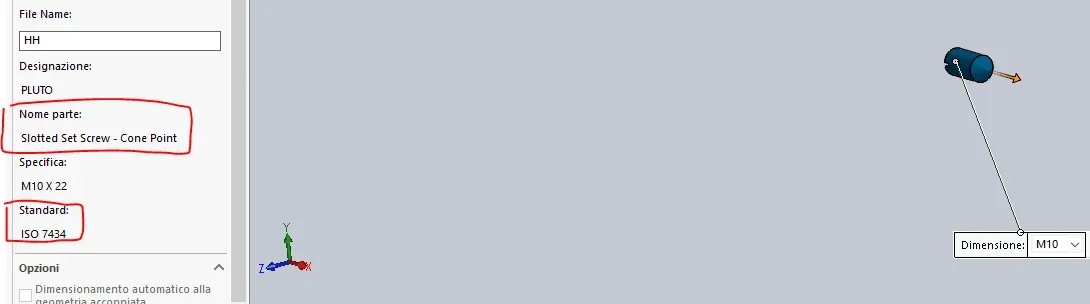

good morning to all, when replicating a file inside the toolbox, I noticed that there is no possibility to change the starting standard and the name part
I'll put you an image to clarify what I'm saying1545994908013.webpI started from iso 7434, and that data remains written to me and I cannot change it, as the name starts in English
I can create custom properties, but those two fields remain and make me confused.
Does anyone know if it is possible to change them? ? ?
Thank you very much
because as you can see from this second image, data remains also in the featuremanager when the toolbox imports the component together, and having incorrect information creates confusion1545997578745.webp
