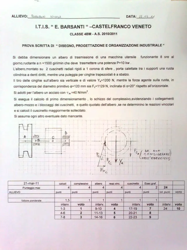

How does this design test work?
studying, I think.
and then:
1) put the photo straight instead of 90° turn
2) propose your solution and then discuss it. learning stems from the critical process of review, and not from being suggested the solutions. unless one studies only to pass the exams and not to learn, benign.

the guide online solution to your exercise is the following:
- analysis of powers and force agents
- balance sheet and action/reactions on the tree due to the cinematic interaction of the components
- sizing first approximation shaft as well as static verification of the above through rules and rules of good classical design
- draw according to rules of good criterion the system of locking / housing bearings on shaft and hub
- according to static analysis check the most stressed bearing evaluated under dynamic action conditions by looking at binding reactions. use unified method for calculating duration.
for the rest we wait for you.
... I forgot: It is appreciated that you turn the image of the text of the exercise, in order to avoid getting us to take the monitor and turn it 90° on the table, maybe to you it is easy...you are young...we have a certain age:biggrin:
