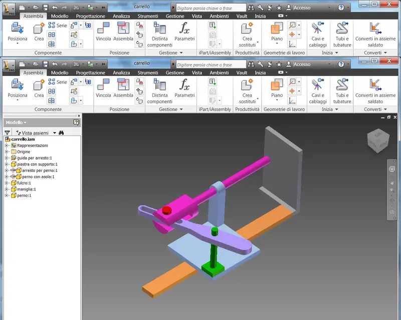

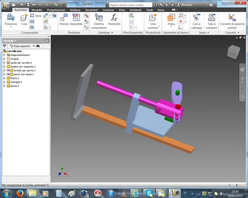

I send the model of the most complex mechanism I am developing thanks to your valuable help.
when I try to animate the "allined 6" bond of the plate part with support, just the pin with magenta fork comes in contact with the gray plate the program "explodes". I noticed that if I do not join the fork the asolate handle (transitional vine between the red pin and the handle's socket) the animation not from problems, then I assume that there is something that does not go in the magenta-brown red-brown violet asolate kinematic chain. . .
if someone can be interested from an educational point of view thank you in advance!!
greetings
p.s. ( Sending other posts with missing parts)
View attachment perno con asola.zipView attachment perno.zipView attachment piastra con supporto.zipmeccanismo.webp
