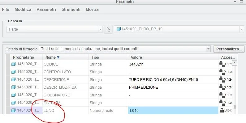

Please ask if you can insert the length parameter (in particular tubes modeled with the system of the hose) within the columns of the axieme model tree in which they are located.
I also ask if you can export this parameter in a .xlsx format report, as well as by attached screenshoot.
I press that the length value is not an attribute that fills it on all components, as from screenshoot you will see that the value is compiled in the variable table of every single part that needs it.

in the template tree you can display any parameter in a model.Clipboard01.webpif the parameter is not present in the axieme you must force it in the field "name".
for export you must use the "save model tree" function that exportes the model tree data in txt format (not xlsx).Clipboard01.webp
