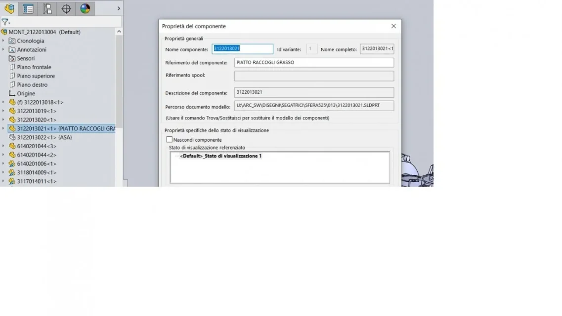

Attached 222 is a set consisting of some details of which one is called "piatto collects fat", okay?
I want it to be automatically written "piatto collects fat", not that I should write it by hand in the properties of the component, as from Annex 22222.
I can't do it. . .

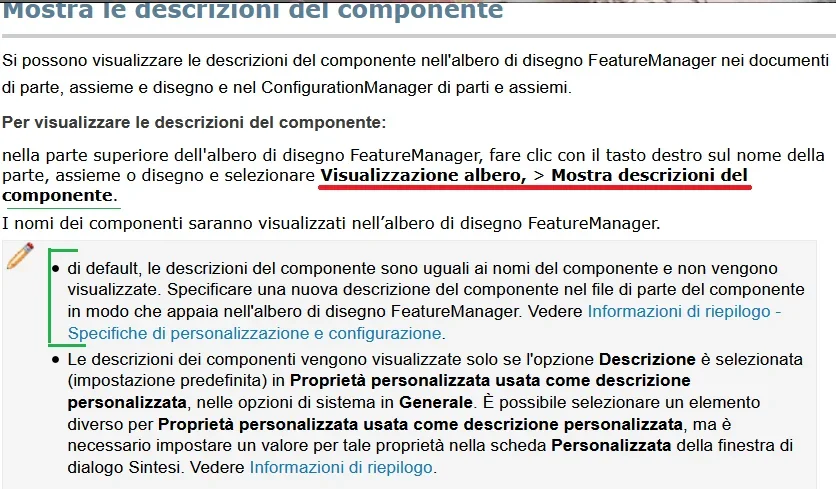

I'll make it short.
Slave with the name of the axieme, on the lower screen, under the type of extension, find the description field, press on add description and write to us what you need.
then as from image I attached imposed on exhibition component description
Maybe I figured something out... Attached I found where to select you see?
"description" is the voice that recalls the name of the component, but nothing comes out because it is actually not description but naming my specific voice.
How do I name this table? not description but name. . .
So what I wrote to you didn't help anything?
No no, it's served and I thank you, I came to this point thanks to you but now I've planted because the problem is in fact that the description "tree" appears on the cartiglio for example on a particular, but the field to be compiled is denomination, while the default field is description, and I didn't match it. I don't know if it's clear.... maybe I've explained badly. I mean, I realized that this is the description, and this is another description, but it's standard voices, but maybe I have to insert a new one?
in the folder you must connect to the property of the side file or together. that this property is called name, description, vattelapesca does not matter
