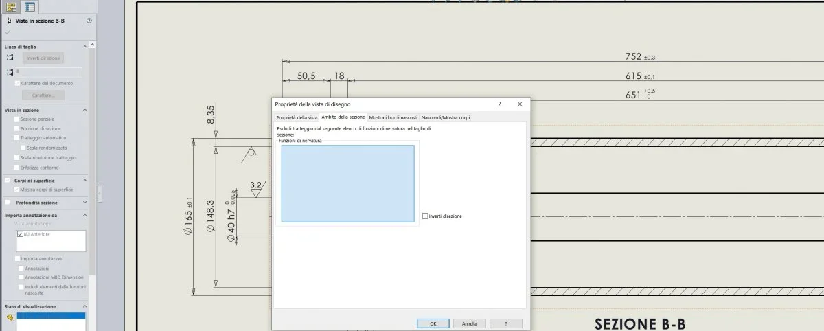

Hello, how do you delete the restraints in the section of a tree in the table? But not just the restraints, I take the section out, I mean, you don't have to cut it, you don't have to disappear the edge lines... I'm drawing pictures, you see the edges are missing?
whether it is a multibody or a set with the scope section excludes components from the section activity.
I came here, but then I can't do anything anymore.
in multibody environment you can exclude from the section only the ribs, so not the trees, that having no function suitable for their creation (the ribs have it) are considered as any other body
in the environment together instead you can exclude any component.
