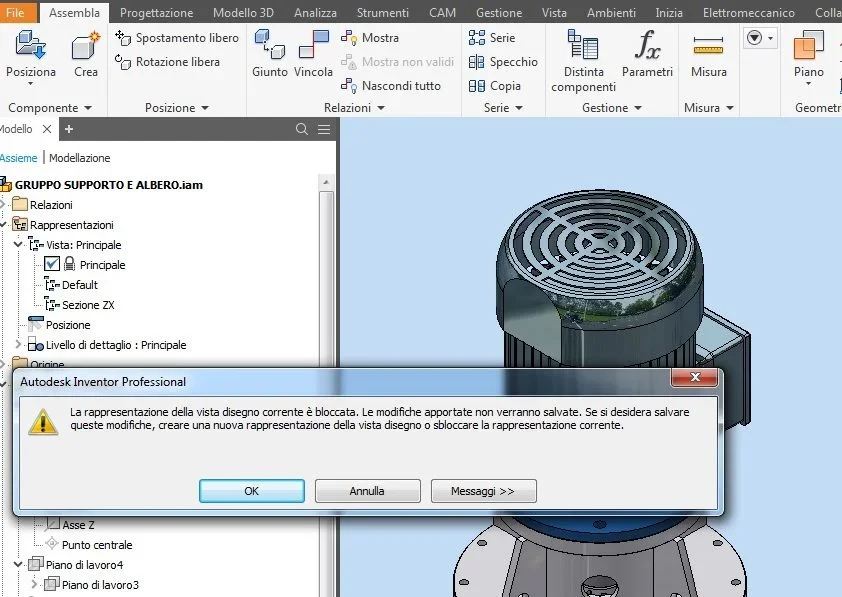

Tarkus Guest Sep 12, 2019 #1 Hello everyone, as from title and image, it does not save the changes to the view (I turned off the plans in one part) and do not want to create a new view. How do you unlock the current view?? ? ? ? ? but then who will have blocked it.... Attachments Vista bloccata.webp 67.1 KB · Views: 16
TECNOMODEL Guest Sep 12, 2019 #2 If I remember the main view is always blocked, you must activate default.
Zac69 Guest Sep 13, 2019 #3 TECNOMODEL said: If I remember the main view is always blocked, you must activate default. Click to expand... I agree
