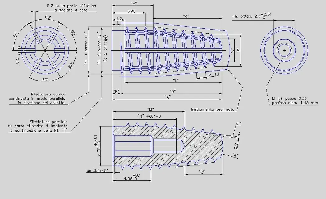

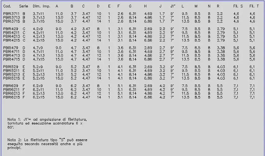

hi guys are new to the forum and I wanted to put you to the test... :biggrin: ...
I have to create these two files with inventor 2010 but nn is how to create the thread in question on the attached files.
Could you please help me? thanks in advance for the interest.thanks
