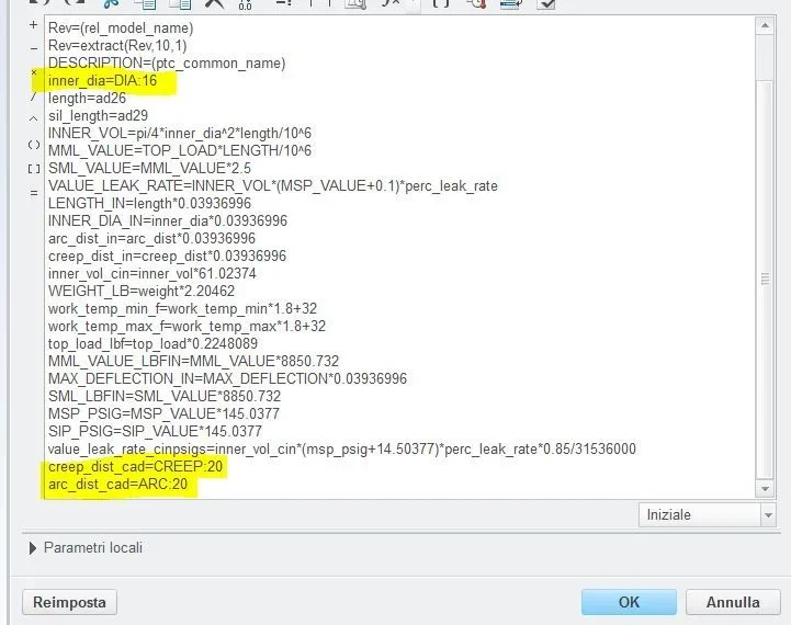

I now proceed just as dani-3d suggests, but what generates this process are links of this type (evidenced):Cattura.webpI rename the file together I would maintain the ties but being forced to change the parts contained in the axieme, to create the new one, and not being able to rename the parts and modify them to create new ones because or are created with family table or can be used by others together, what I would get is an axieme with a parameter that points to a part that is no longer contained in the axieme itself.
What I do not understand, however, is how I create these bonds, or why I get the link between the axieme parameter and the part parameter followed by the character: and a number?
I also thought of commenting on the ties with /*, then betting but I had cmq the problem of writing the tie so that the parameter is searched directly in the part otherwise it generates an error.
