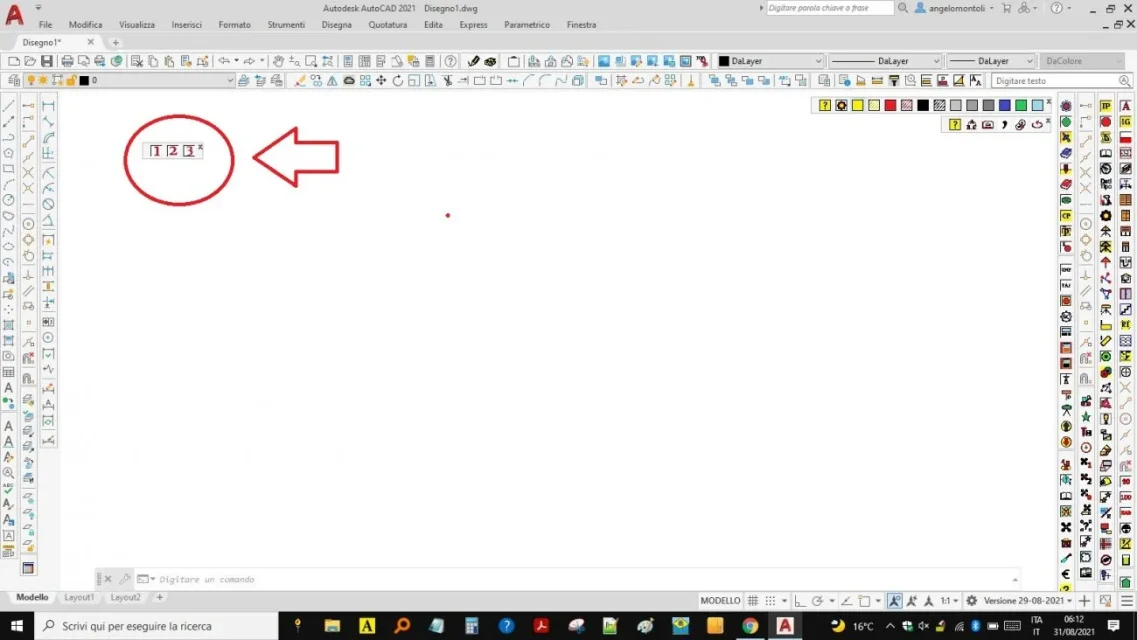

I would like to make icons that behave, in autocad, like keys of a keyboard that writes in the command line.
in a very old version of autocad, I had already made these keys, we were still in the era of the dos, I do not remember how I had succeeded.
key a: you need to create the .bmp files of the letter, start the command, create the new command, maybe call it a key, to which you will check the bmp and enter as a command
I already created .bmp keys but how do I tell the program to write in the command line?
thanks rpor66,
As already told you, my problem is not in the realization of icons (see attached image) but in the .lsp program that should write in the command line.
