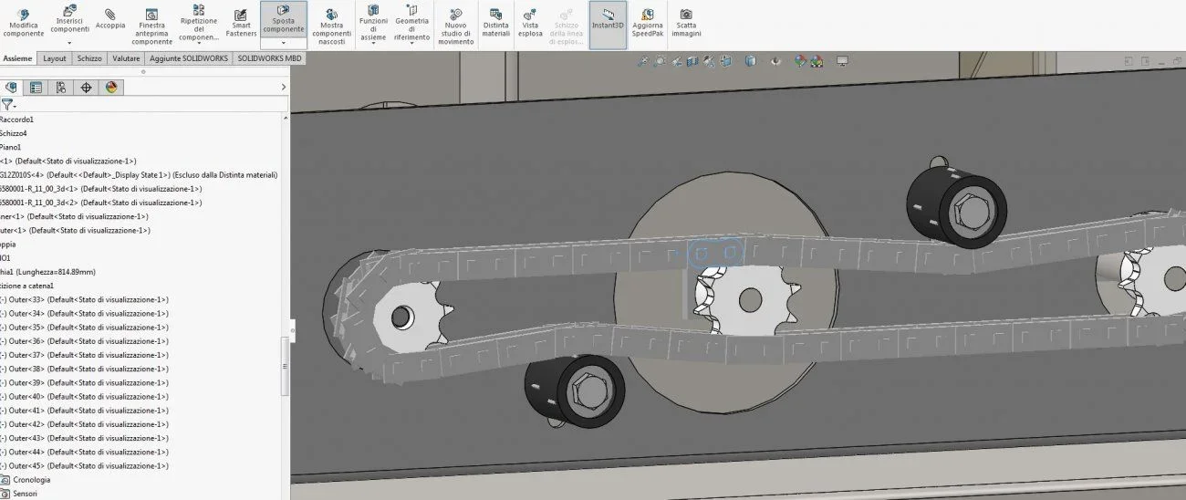

hello to all, when I carry out a "important" drag within a set at the time when I transpose the component, the whole detail becomes a cube equal to the size of the encumbrance or is not sharper as it should (as in the image below) depends on my video card or is it just a setting to calibrate on solidworks? Thank you.foto1.webp
certain in the document property settings there is the details tab and you will find two sliders that you can adjust from low to high quality.
