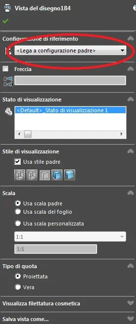

I am talking about sw2016
when I create a table insert the main view, then the derived ones (lateral and above typically)
I would like these views to already have the configuration property "as a father view" and not have to select it every time
this because if I go to change the configuration of the main view I would also like the derived views to follow this change automatically, by default
I looked in options but found nothing.. .
Are you talking about this default selected option? Right?
exactly, just that I didn't configure it by default and I have to set it up for each derived view. . .
But thank you! is exactly what I was looking for (and obviously there was no flag on the option)
Thanks again
