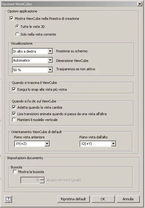

I have a problem with "esthetics" which then becomes a real problem in inventor studio.
when I create a new part the view cube is correctly positioned as in this image:view cube ok.webpinstead after clikkato the home symbol the view cube rotates me in this position:view cube home.webpUntil today I didn't give much weight to the thing, clikkavo home and I started drawing using as xy horizontal plane.
These days I've been testing with inventor studio and I find myself on the ground instead of down.
I tried to change these settings:view cube option.webpBut as for the home key, nothing changes.
Is there a possibility to customize the location of the view cube home key?
I came by myself... I discovered hot water... .
even if sincerely it seems to me more a piece than a definitive solution:
put the view cube in the correct position
key above the iconcin with the cottage
set current view as start
the game is done!
