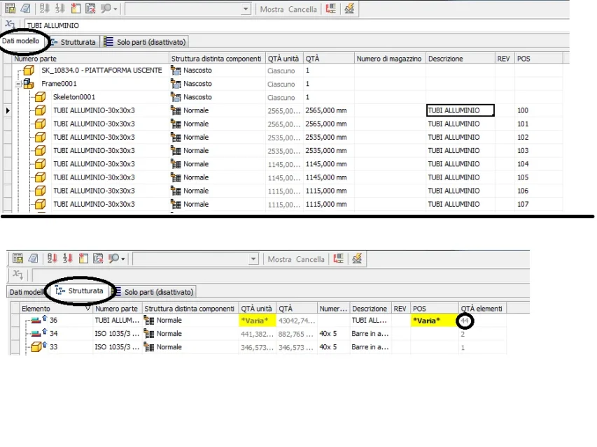

Good morning.
I can't see on the separate components of a set the individual tubes. on other axioms made long ago I could safely, can someone explain how to do it?
Thank you all!

more precisely: I misunderstood the question but did not understand the result you want to get: the total quality of the tube or a list of 5pz tube axb l=1000, 7pz tube axb l=1500, etc. etc.
each tube has the same number part for which in structure by default are added all components that have the same number part. for so long there are 44 tubes of different lengths, the sum of all lengths is returned in q.ta. to make sure that you don't gather all the pipes you have to uncheck the union of the parts by number part. If you look up on the bar there is the button.
you have hit the problem and you have solved it!, thank you very much to all!:finger:
