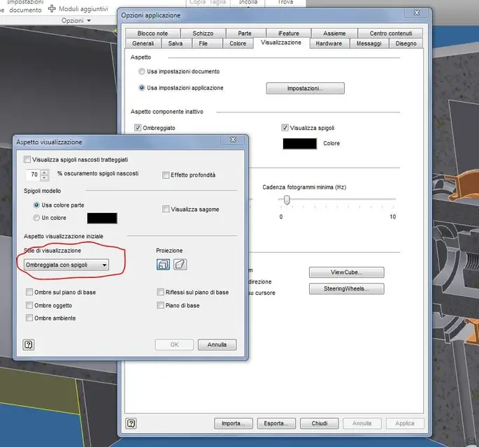

I have installed inventor suite 2011 recently and I am trying it, and in the environment together if I do a section (1/4, half or 3/4) I see the edges of the "hidden" part of the axieme...... How do I remove them?
if I change the style from "shaded with edges" in "shaded" you no longer see the edges on the section.........
if instead I put color edges as part, there is no problem....mah
I am trying to see if I understood the problem, but it seems to me that however with the new (different) management of display styles by document or by application, there is something that does not go... at least I, even changing in the windows of the application options or document settings the display modes, do not hold them or do not change. only if I change them from the ribbon-bar, do you understand?
I press that I have correctly set "use document settings" or "use application settings" to check both ways....
the changes that are made by the ribbon bar should be "flying" or for need of the moment, while from application options will be your standard.
try to change it from "looking view"
Cattura.webpthat does not take away that I can not put the edges of black color and not see them in section.... what always made with the old inventor
