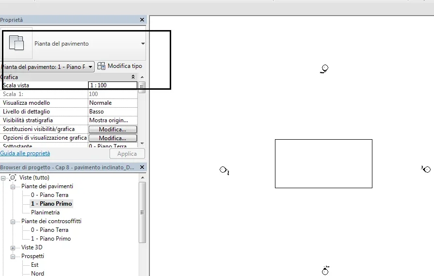

I have a question. I've been tilted to floor 0 to 1.
on the view of the plant 0 you see only one part while it is entirely visible in level 1. plant
to what height does the view for the different floors?
because at level 0 of the countertop has towards in the other direction and level 1 of the countertop is null?
Livello 1 controsoffitto.webpLivello 0 controsoffitto.webpLivello 2.webpLivello 1.webp
I have a problem with the depth of the views
I created two floors: one on floor 0 and one on floor -1 with distance one and the other -3.1 m.
that on plan 0 is about half of that on floor -1 (so should see the one on floor -1).
if I change the viewing range in the depth of the views in the plant 0 if I put 0 as viewing depth shows me nothing. if I put only -0.1m shows me everything.
Shouldn't you show me everything if the offset was at least as long as the difference between the two levels (-3.1m)?
ps. but can you attach .rvt files here?
Livello 0 - proprietà vista.webpLivello 1 - proprietà vista.webpEst - prospetto - proprietà vista.webp
