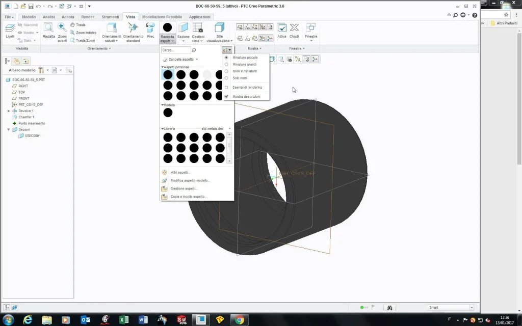

I have a problem that comes to me after the re-installation of creo 3.0 due to pc maintenance.
In essence, the visualization "takes" appears completely blackened, no longer then rederized, in order to have the chromatically comprehensible aspects I have to for force the item to appear in the menu "examples of rendering".
Other times I have been forced to reinstall creo, but never find this problem.
Maybe there's a setting to do, which I might have done time ago and now I don't remember anymore...
One last thing... maintenance on the pc was due to the replacement of the video card... Now I don't think he can do anything or do I? also because I do not seem to detect video problems on other software. . .
place some pictures for greater clarity of the whole.

Hello everyone,
So... I did a test by reassembling the old video card and... with my astonishment the problem disappears... the old card is a nvidia geforce.. the current is a radeon ati... I'm convinced it's drivers. but the current I have for the ati radeon is the most recent... do you have any suggestions about this?
ps: I tried to return to the previous version of the driver.. But I do not even start... I guess you should reinstall it.. with the risk that you do not bring to any solution. . However, the problem is not only about "taking aspects" but rather the display of the whole model. .
I look forward to your pamphlet / answer. .
placed below some pictures that make the difference good

thanks for the answer 320i s,
from how much I have seen I create does not hit much, while the video card yes.. Unfortunately, to better say I think the drivers of the card are not compatible with creo.
I have already made arrangements to replace the card.. Let's see how everything evolves.
