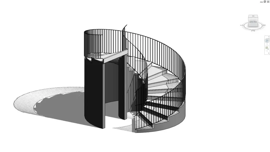

Hello everyone.. I'm making a scale with curved profile...it comes to create a space under the stairs just that I can't hide. . . how do I create a curved wall that has as a higher delimation, the lower profile of the scale??? Thank you
if you do not need to create monolithic, you can "transform" the pillars in walls
hi, I no longer remember if I read it on bimtroublemaker, cmq a tutorial suggested using the ramp tool to model the wall under the curved scale (the impose as large as the thickness you need and for the slope put the percentage ratio between the pawn and raised of the scale) if you have to add openings on this "muro" surely the only solution is the in-place modeling suggested by tristan
