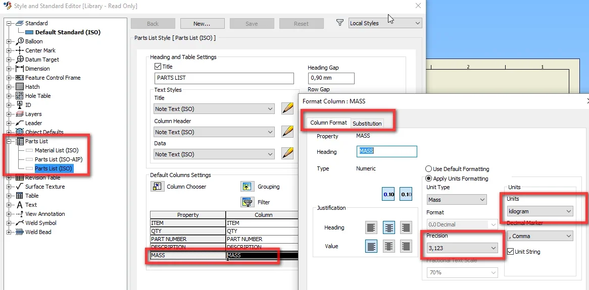

Hello.
in my distinct corporate base we have both the unit and total weights related to the individual voices.
for example a d3 washer as weight comes 0 and then as total weight because I have 50 it comes 0.035kg
How can I have the weight of the single washer? Do I have to increase precision or up to the gram?
How do you do that?
I would also like to have all columns with 3 decimals or 0.145 kg for example.
How do you change these settings?
Do everything with table styles.Bom1.webpBom2.webpremember to save everything in the template file
