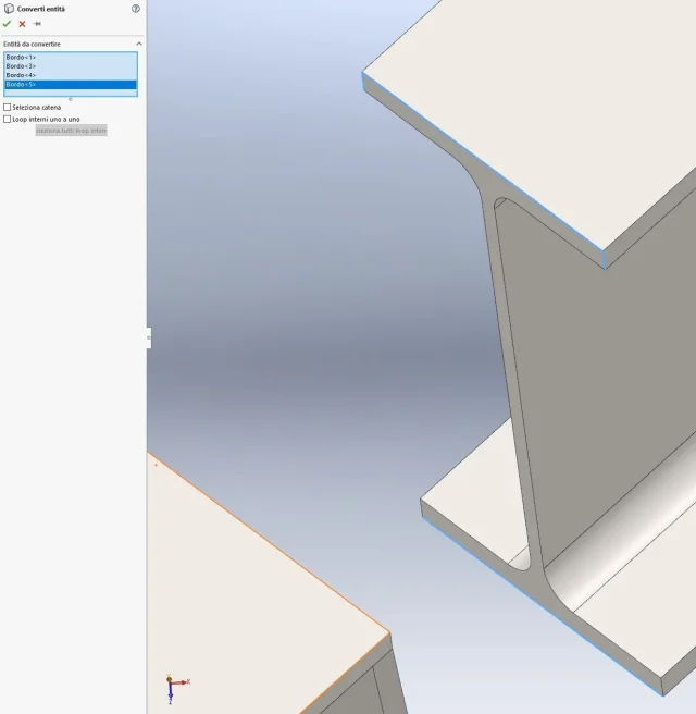

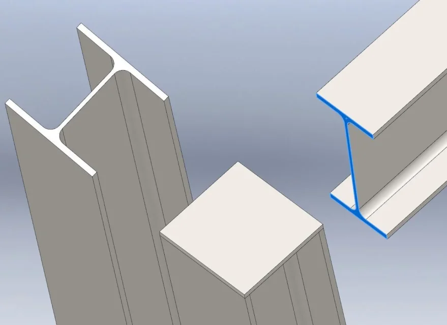

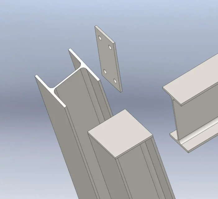

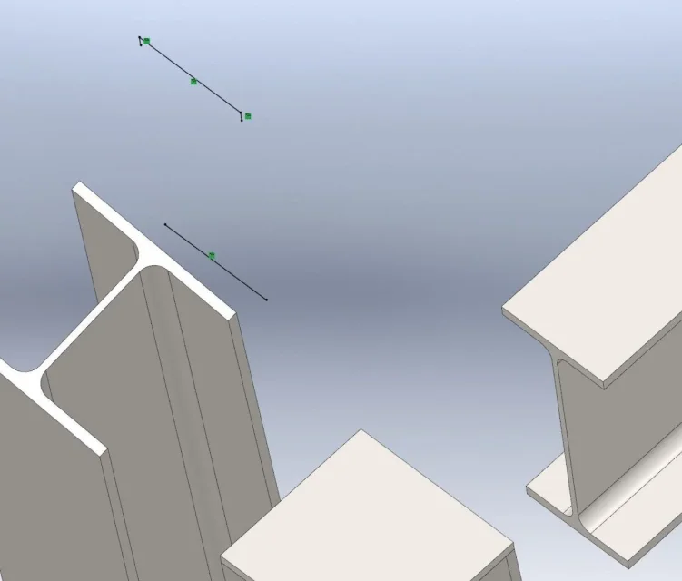

I was semply shaping a small structure and I was drawing a plate in the face of the beam, so I am making a sketch on this face1.webpthen with convert entities I took as reference the following edges2.webpgetting, wonder of wonders, this conversion3.webpthat in the end has rightly created me this plate4.webpIt's the first time I've been through this, trivial operations I just don't understand. Are you getting weird things, too?

I have to say that sometimes this thing has given me amazing results. sometimes control+q put everything back in place, in other cases I first created the plane entity on the face, then I did the sketch on that.
I've been able to lose a little time with no regeneration. I cut the beam with the short-extended function of welds on a floor. initially the plan, x my superficiality, was not perfectly peppermint to the side face of the beam and gave me this result. making the plan perfectly perpendicular all normal. I honestly don't explain, even on a cutting plan not perpendicular creating the sketch on the face I shouldn't have got what I got... Mah.

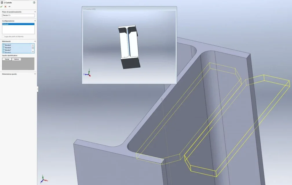

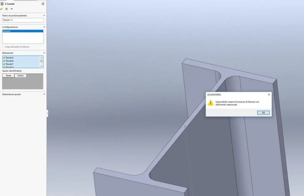

with the 2016 version I created library functions like that of the reinforcement ribs on double t. beams since I upgraded to 2017 I had no longer used them. I got them back today, and they don't work for me anymore. Did this happen to you?
the function at the end of the insertion of references1.webpgives me the following error2.webpI can't put them anymore!
Do you know if x case are to be updated somehow to the new version? In case how?
If you have any ideas, let me know... thank you
