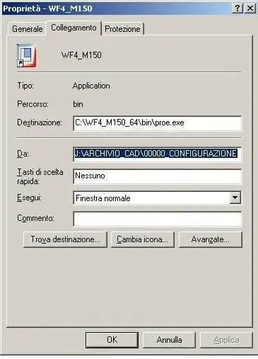

the starting directory is specified in the startup icon.
Right-click on the program's starting icon and then look at the attached image.
in the "from" input box you must specify the above directory.
I checked.
the link string is right, i.e. inside that path you will find all the files, including config.pro and .dat
