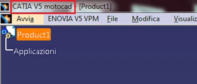

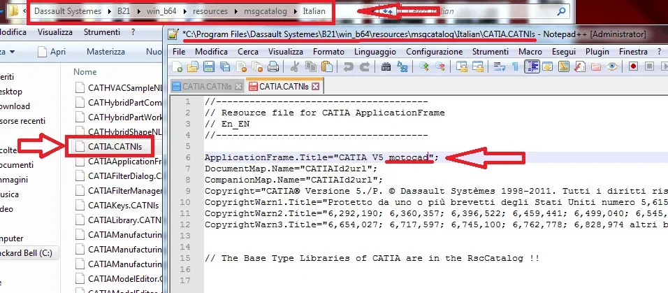

in addition to the correct suggestion of motocad, I recommend:

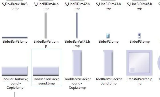

cercando toolbar ho trovato
\win_b64\resources\graphic\icons\
toolbarhorbackground.bmp as first proof, I modified the horizontal, putting it totally in black,
Catia hears the change, but perhaps there is a control
in the horizontal bar there is no more shade, but remains in the vertical (not modified)
yesterday I modified it in gimp, to change color keeping a little shade
I just tried paint.
It's a start...
Now I have to find the way for the gang above and below,
I worked on local copies and then overwritten. the images have a color palette set inside them, and for this reason it had initially problems loading the image; I am not an expert in palette replacements, I am limited at the moment to a solid paint color; with calm also the logo

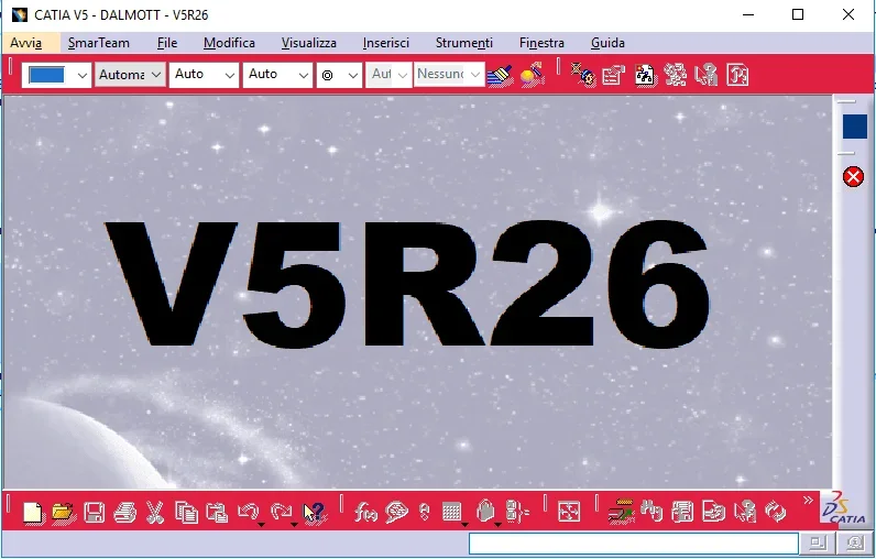

I would have the need to insert in the background as Dalmott wrote that identifies the version to use - a further anti mistake - when you start catia.. .
which file should I edit and where can I find it?

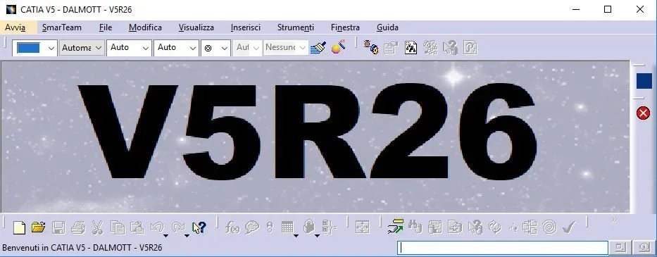

Okay that system.. I saw that instead to insert a written in the background like the black one you have to edit the file : clientmdibackgroundnt
Present in the path : program files\dassault systemes\b25\win_b64\resources\graphic\icons
and save it in 24-bit .bmp format
only thing that when it opens it clears the image because the starting one is bigger.. .
but still fits what I wanted.. .
