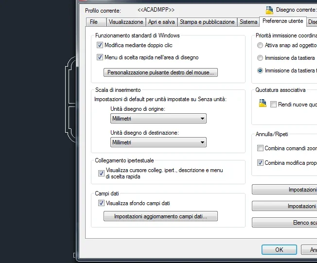

if, as the catafract says, type: "unit", in the dialog box in addition to the settling of the unit there is also "unit for the scale adaptation of the inserted content".
I don't know if there's anything to do with it, but did you check that in mm too?

I thought once I set the insertion design unit as an image,Catturaunita.webpbut I actually found that the unit variable and that of the image are not the same thing
Thank you very much I solved a boredom that haunted me for a long time.
