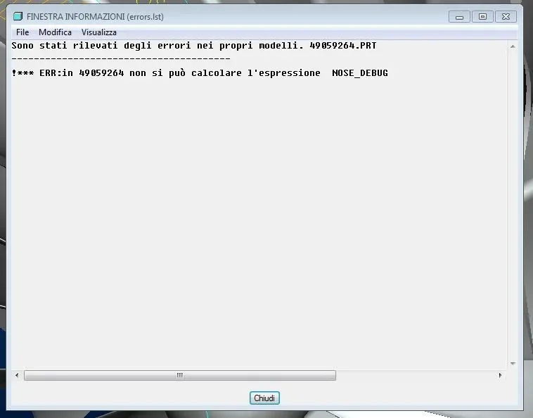

Unfortunately I left on one side set by others and is creating problems because when I try to recover some suppressed features I give the following message: no nose debug (see attachment)
It's the first time I get it, what you mean by "expression" and how I can eliminate it.

before recovering the deleted features, maybe try opening the log panel. Maybe there's an expression like this: nose_debug=xxx+yyy+zzz which has problems.
to turn it into comment just before /* at the beginning of the report line

I had already looked into relationships but nothing to do. It's still the only part that has this problem.
Unfortunately as I used to go in a hurry and I had to create another design.
Moreover the person who created the part can no longer contact and can not ask for clarifications, patience
thanks anyway for the help
happy year to all
recapture the features suppressed once in a time and, when the error returns, the relationship probably finds it inside the sketch of the feature itself (in the definition phase of the sketch you find it under tools-> relationships).
