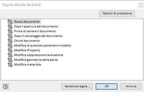

In practice you can create an ilogic rule, activated by the preferred event trigger (e.g. before the rescue), which starts one or more macros, such as the one that exported pdf/dxf/dwg or that of the scales in cartiglio so much to understand.
