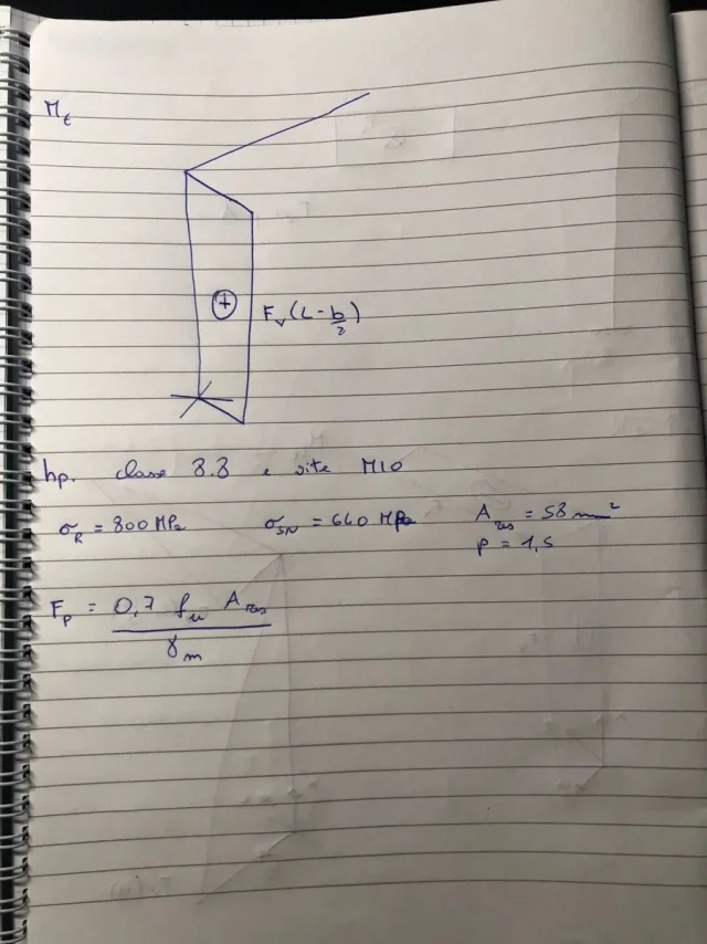

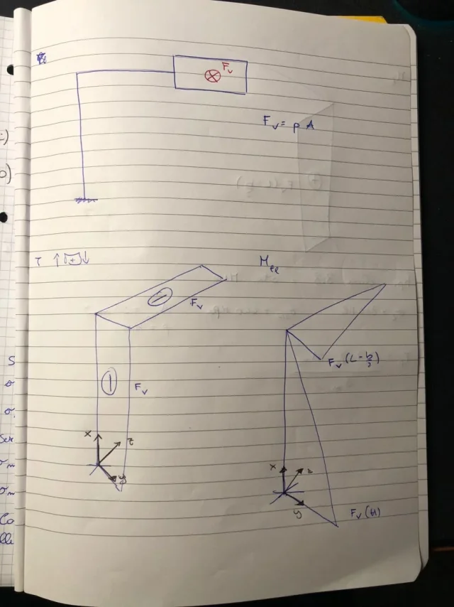

One thing is not clear to me when I do the verification I must also consider the precarious force, or just the cutting force? Moreover the verification I have to do only on the bolt most stressed right.I sincerely see a series of copies and pastes without explanations.
the development of what must be done includes:
- application forces on the simplified structure
- determination of ground reactions at the center of the base plate
- is not asked to dimensional the pipe of the pole
- for bolting to use uni en iso 1993-1-8 i.e. eurocode 3....other methods are not to norm and could only be academic (uni cnr 10011 or similar)
- it is important to evaluate how the base plate reacts and how you want to treat it (deformable plate or not)
just to give you an ambush... look at this debate where we talk about elastic method.
your screws will see different components and you have to hypothesize the center of every effect.
for eurocode 3 you have these cases for bolts:
You must follow the rules. the laws and you will see that everything is explained well. the precarious is one thing. the strong load is another.One thing is not clear to me when I do the verification I must also consider the precarious force, or just the cutting force? Moreover the verification I have to do only on the bolt most stressed right.
