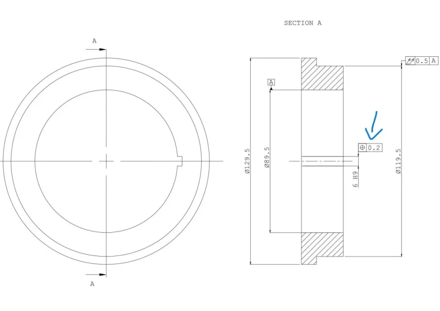

I have been looking for a code on pc-dmis that helps me verify this tolerance of position:
sample rev1.webpRegardless of the software, I tried to tastare points within the venue to extrapolate average points to assess their coordination with respect to the ø89.5 cylinder axis.
Does anyone have any ideas/points or have ever dealt with this kind of control?
Thank you so much in advance!

hi, to logic rigor you have to make two measurements: between the two edges to verify 6h9 and the other that the average straight is ±0,2.
it is necessary to take the norm and read carefully as it considers geometric entities.
the iso 1101 for the speech position without datum says to go to see iso 5458.
