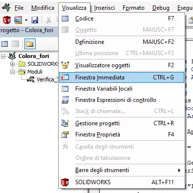

Hi, you know that you don't have the immediate open window, that is, it's a white window on which the macro shows the values you want to appear right on this window. to have this window in your interface just go to the drop-down menu "view"-> immediate window (see image)sembra così facile,ma dove mi perdo allora?![]()
