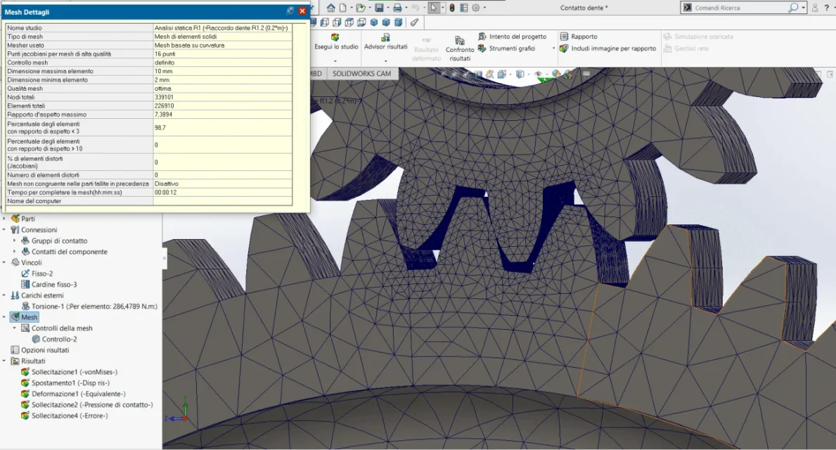

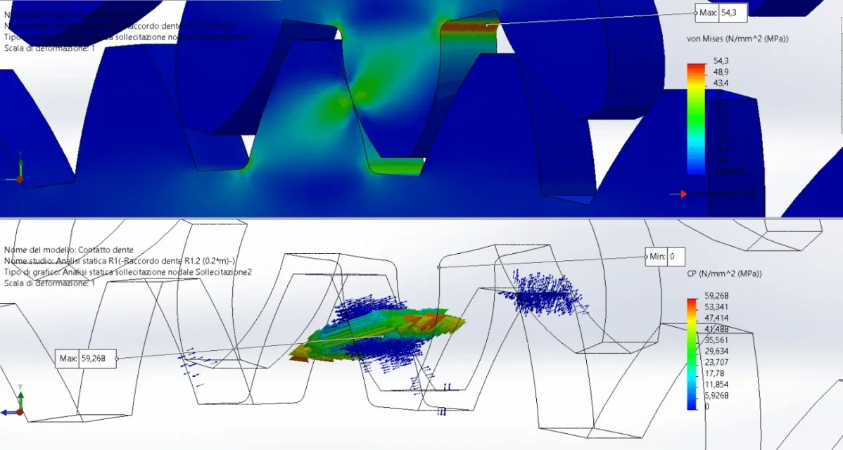

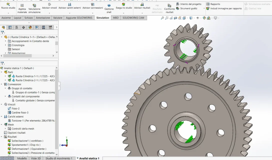

I would like to ask you a problem that I'm facing, since I didn't find treads inherent in my research here on the forum. I am analyzing the contact pressures between teeth of toothed wheels, on the occasion of a project of a gearbox related to my graduation thesis.
what I kindly ask you, are clarifications or confirmations on my procedure in defining constraints and forces in the simulation environment of solidworks (linear static analysis). after defining the materials created by me (I did not find them in the default library) I imposed as constraints, a pinion pin (the wheel on which I applied then the torque) and the wheel conducted I made it fixed. both the torque and the constraints I applied them on the inner face that would go in contact with the tree (allego screen).
According to your opinion, could this model approach me to the analysis of contact according to hertzian theory, being aware that it is not the best?
If I may not have been very clear, I can relay the whole even more in detail.
