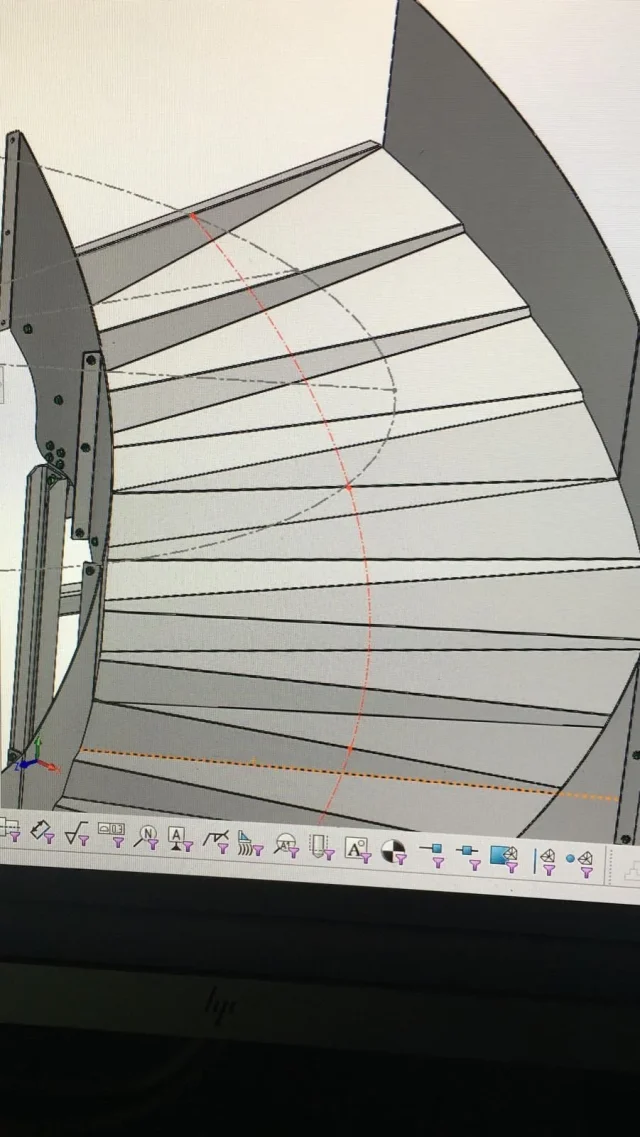

Hi, hustle. I was thinking about how it is possible to discuss the sheet bending in many linear pieces?
the idea and that of getting something of the type attached in photo.
I attach the sheet metal slide that I managed to do.
the edges on the curved part I made them with 3d sketches and loft function sheet.
I can't do more. What do you say?
I think it's a great idea to make the vertical banks like that. I didn't think about it.
In this way, a vote has improved all the measures, one should succeed and bring out the developments. Then, as they build it, I have no idea.
Of course it's a workman... do first to build it that to draw it almost
you are really a workman.
regarding the discretization of the curved sheet you think?
Discretization for me is a bad word.. .
One thing is drawing, another is building it. This sheet is like a piece of cochlea. great what I think it's the only way I'm gonna do, but you need to talk to who's gonna have to build it and get along with it.
Excuse me and if you want to change the section in the middle of the curve?
i.e. widen at the center of the curve by changing the section?
Isn't the propeller okay with loft?
I send you a pdf file to understand

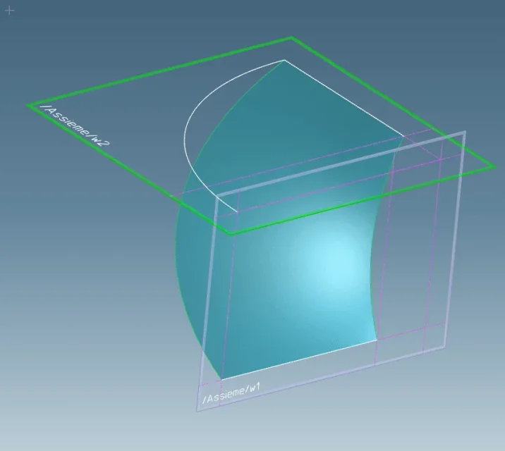

Good evening,
I send a curve step file modeled with software that fits like merenda cabbages with sw,
But maybe you need it. However apart from everything, this curve is nice steep!
