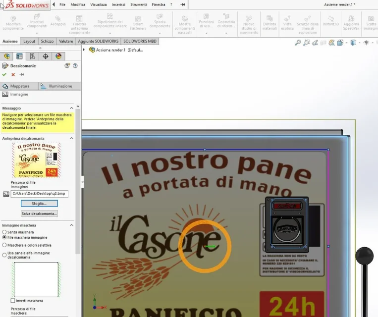

decalco e ritaglio
Now I understand. .
the inside of the alpha image should not contain the image, but must be white, what you want to remove must be black
Now it wouldn't even be bad if it was because I find the cut writings.. An endless story... .
in the alpha image you do not have to put black bands on the sides and above and below, otherwise you will subtract part of image that you have to stay, of black you should only have rounded edges
It is not possible.. Now I've disappeared the words... It's really an infinite thing... :
solved atreiuo, there was the image still imprecise.. it must be practically his part to match that 100% alpha.
you need to get the alpha image from the original image, otherwise you don't come out of it
