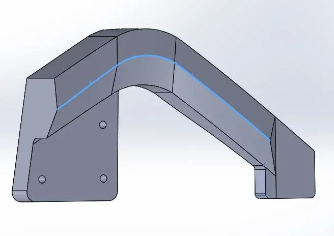

I would like to further improve the loft by adding a sketch with a half-mill like the one highlighted.
the part in its three dimensions, however, looks like this:
so to create a half-carry as I would, the only way that comes to mind is by drawing a line with 3d sketch.If you just don't want to do the 3d sketch (for granted that you have to have your line of half-carry that drives the loft anyway in 3d) you can make on the vertical plane an extruded surface starting from the shape on that plane of your curve, then drawings on the plan offer it a curve that represents the course from that view and the projectors on the surface. the vurva thus obtained the use as a line of loft halfway. the method is rognose because you have to make the various end starting points coincide with the sections of the loft etc. at the end that curve is extremely simple as sketch 3d, regardless of whether it is composed of strings or whether it is a spline. with a bit of reference geometry (fixed constructions along the reference directions x, y, z) always inside the sketch 3d, controls all smoothlyHowever, I try to explain myself better.
What you see in the highlighted photo is a loft extrusion, with the two edges, super and lower, which do as guide curves.
I want to know, is there another way to create it?
