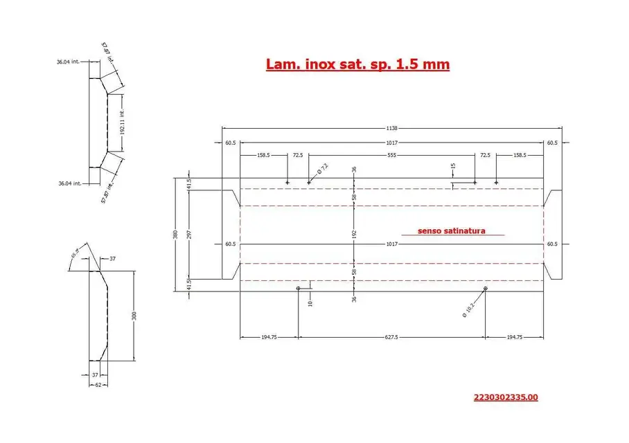

the process is nothing but create projections of the internal faces by combining everything into a unique figure.
in antiquity there was only the tecnigraph, and for me working at the counter, goniometer, teams, row and point of sign.
Try to develop an open cube on one side and then try with a trapezoidal parallelepiped, when you understand the system you can develop everything.
I attach an image to you, look at the notes in red.
for development, project the faces from the inside and as fulcrum the inner edge of the tray.
nb: the attachments are all 2d drawings, take the cue.

realized with autocad 2012 in about 15 minutes.
this piece is perfectly feasible from the r14 version
I rearrange the 3d in version 2007.
for the development of the plates with autocad you have to do to manina
ps: I am not mechanical so there may be some inaccuracies
I wonder how you did I blasphemize when I have to tilt the side plates and then build that under bent!
but in the end I wonder if the 3d serves, if with autocad the table you can not do associative what sense it has or wrong then I lose a lot of time... .
you always start with dismantling the complex figure in various simple forms.
the 3d is not indispensable but helps to have an immediate eyelash of the object
