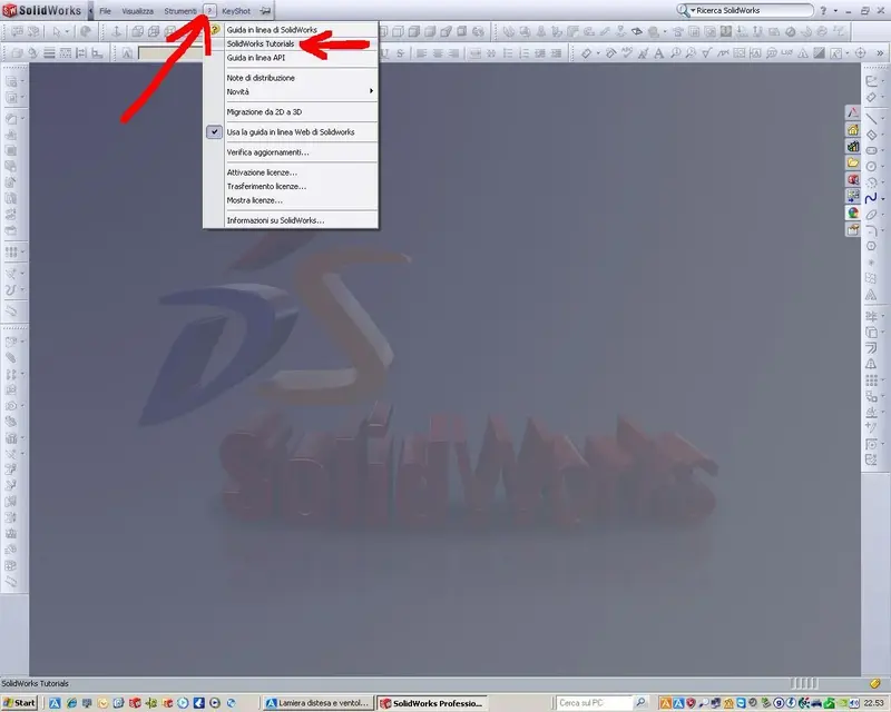

the sheet flattens it or directly on the side, or, as
is more appropriate, in the drawing document that you will create.
from the design insert a view "flat recetition".
If you follow these basic rules you will have no problem.
attached info for tutorials.
