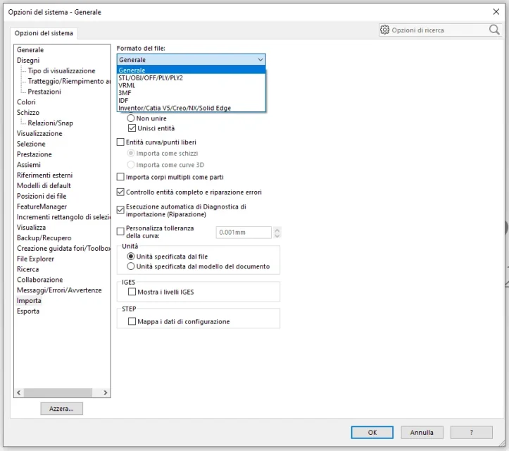

at the opening or with subsequent commands?can convert it into a solid body,
opening it simply, with standard settings. he opens the step file with solidworks 2018 and the software recognizes the piece as full and not surfaces.at the opening or with subsequent commands?
This unfortunately not. However import options should be the same: even he, to select the file chooses "all files" from file type, then the options do not even look at them. However tomorrow I will make better control and update the discussionCan you attach the step?
questo non c'entra nullaeven he, to select the file chooses "all files" from file type,
should be means you didn't control them when if you open it one way and your partner in another was the first thing to do.import options should be the same
