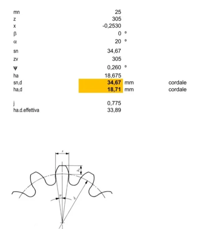

if you check the file I sent you comes to me 34.42 ... up to 18.7
is not the broken calculator... .
the friendly parameters are those indicated below in orange.Screenshot_20200512_232441.webpthen you have to measure like this:Screenshot_20200512_232958.webp

x= - 0,253 ....less no more
I got there with the calculations. I was wrong with the application of the formula.
Now it's all clear to me, I didn't realize that the height of the tooth 18.7 was the point where I had to take the measure.
Finally.
that was what I wanted to understand to verify the correctness of the tooth! !

Consider that if you do the piece with that thickness (34.69 ) is the theoretical share without play, your client gave you 33.87!
in fact browsing the various tolerances that gives me the program I approach the quota indicated in the drawing, the problem is that having gost legislation I do not find the one that corresponds with iso 1328
I'll pass them all until I find the one that gets closer to the required size
