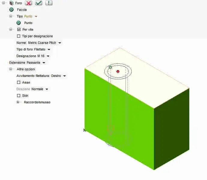

I have another question: is it possible to draw a threaded hole passing and decide the height of the thread? if I use threaded hole passing (or through surface succ) this option is not given to me and it seems impossible, then either I do a pre-work and then over the blind threaded hole with depth equal to that of the threaded height or I do not know just how to do it. .

for the threaded hole passing and decide the length of the thread just use the shaped hole command, decide the length of the hole, the length of the thread and the inclination of the hole depending on whether you use a light tip or not.
hi, with the hole command I saw that if imposed on blind I can decide height and thread height by unlocking a padlock in the graphics area near the hole, though if the hole is set on passer I do not see how to decide the thread height
