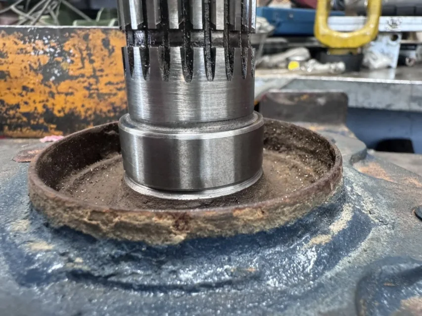

in my industry we send components to undergo material carryovers to obtain superior durability or to recover damaged trees:
pmcsrl.com
I have no idea the costs.
for lip seals an old trick to mitigate the erosion problem, was to work the seat of the seal slightly disassed by the cylinder on which the lip insists, so as to increase the crawling area and make it less localized.
