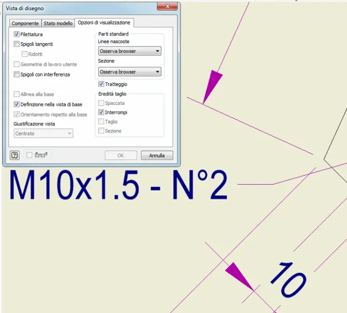

In practice when I create a view on the table I must every time set that thread is active.
If by mistake I forget, inventor no longer updates my view and I have to do it again.Cattura.webpIs there a way to ensure that the "filettatura" check is already set by default?

It is not true that you cannot reset the view of the thread, just double click on the view that interests you and, from the tab "display options ", snacks " thread ".

yes your answer is correct, the problem is that I double-click it, re-imposed "filettatura" and stick it, then in fact the view does not update and I remain the holes without representation.
I guess it's an inventor's problem at this point, but I don't know how to solve it. . .

question: Are you sure that view, in which you say that threads are not seen, is "perpendicular" on the plane on which the threaded holes are present? because if the view is also only slightly inclined to the top of the sheet, the threaded holes will not be seen "correctly".

Cattura2.webpI'll get you an image of the situation. . .
to see the view so I would say that's not the case... I was referring more to the view in the plant. I can't help you then.. .
