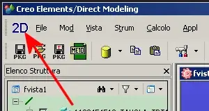

I apologize if I resume this old discussion, but just last night I was watching some video tutorials downloaded from the ptc site, including one of these where he showed how to use the imported dxf profiles in annotation to transfer them to the 3d. at some point he shows up on the video a window where you can make the switch between annotation and modeling, instead of pressing on the darts down to the right as I used to do (I'm still learning ...). I almost pressed all the buttons and buttons unimaginable but I never see that choice. Maybe someone remembers how this passage takes place. Thank you. Hello!

I'll show you how I set this up.
I pulled out in the bar 3d and 2d commands to move from one mode to the other
by the way the first time I click on 2d I charge automatic annotation

@shaba: Thank you very much for the tip, which obviously worked on the ribbon bar of 18.1.
