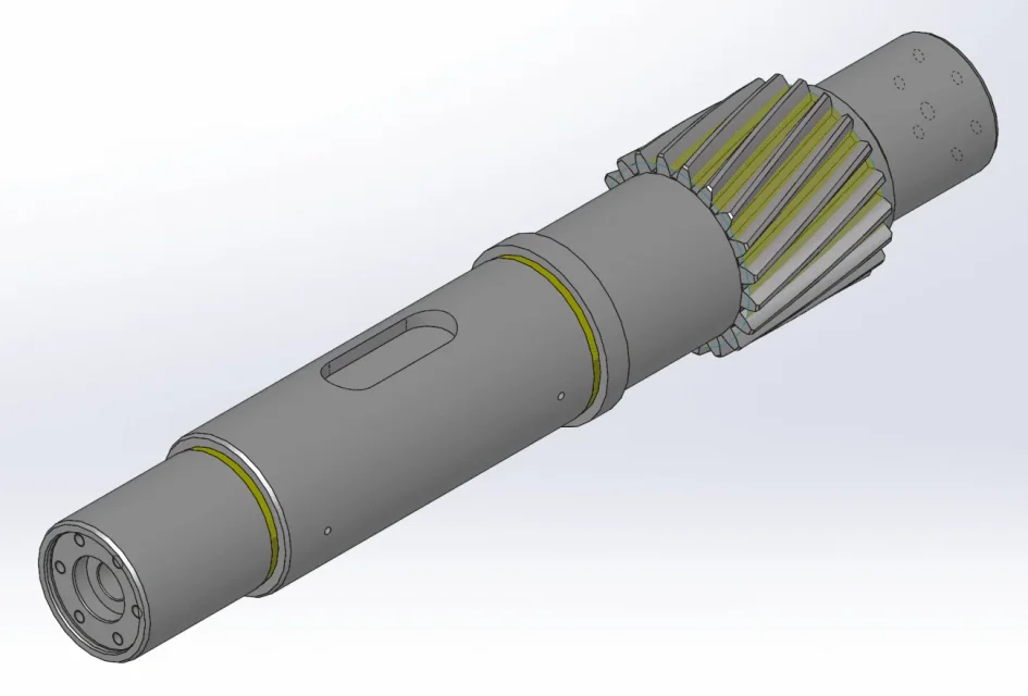

dentate wheels created with toolboxes can easily change them as if they were normal sdw files.
Once created using toolbox, I suggest you remove the link to the toolbox (you can avoid regenerating problems with the added features).
with the toolboxes you have difficulty managing the correct dentate wheels, but just put some in the parameters and you should be able to solve the geometry correctly.
I always make a simplified configuration where I exclude tooth modeling (in this way recalculating times are much faster).
the groove should add it to the toothed wheel later. What do you need?
