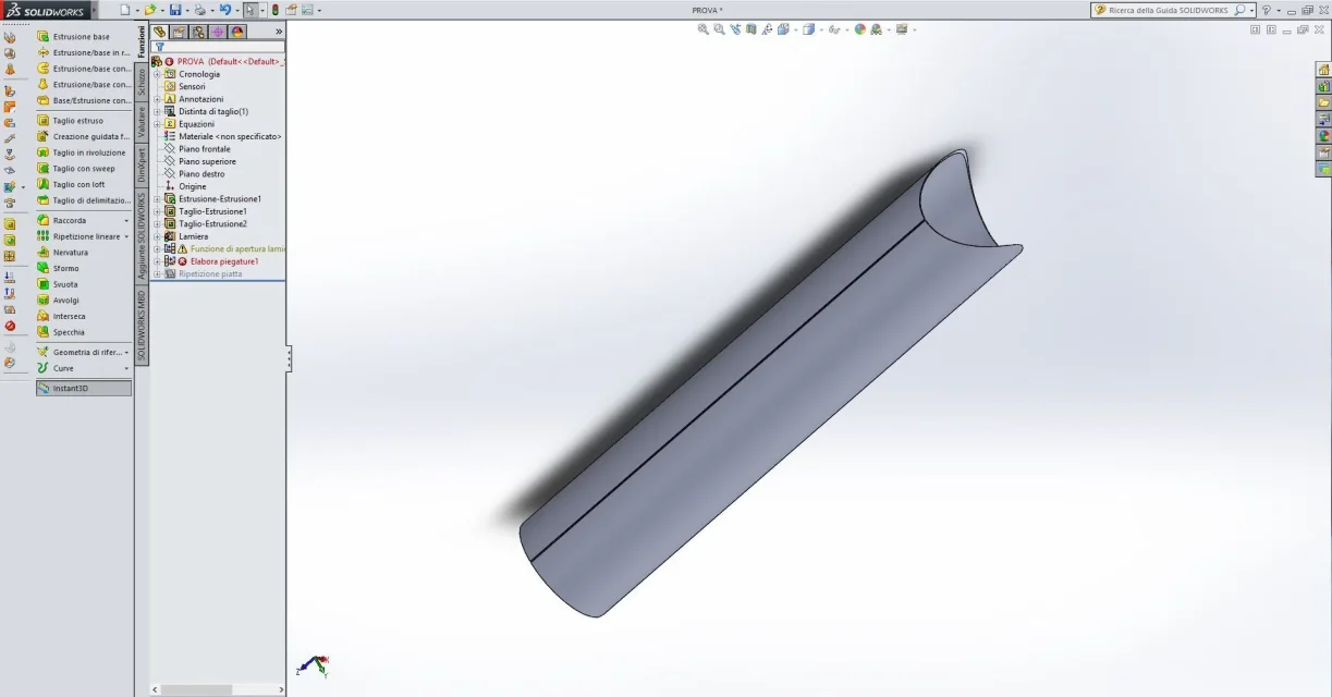

I have to make a dip tube to be sent to the laser so I need to work it in sheet metal and then stretch it.
I have already read suggestions like the following about how to do it but I can't.
"with extruded cut parts as plane from one of the two faces "head", sketches a closed silhouette (I make a sort of isoscele trapeze with the radial tilted sides and the bases circle arches on the outer and inner circonf of the tube. as a term condition from the blind and the length of the tube (or more convenient passing, or until the next). sending and cutting is done.
now you have to turn that pipe cut into a sheet metal;
insert > sheet > folds in the first panel at high selections one of the two longitudinal edges (split) that have resulted from the cutting before, sending and you have your sheet "rolled" (check the featur manager as it has changed and what has been added).
now always to insert > sheet > extend touches still one of the edges of the cut, the cylindrical face, sending and you have your tube "distinct on the top".
It's very simple and swx allows you to do this and other with the plates. "
tells me errors in the reconstruction, select one or more folds

then I have to make a tube and make it in sheet metal for displacement and then obtain it lying and create the dxf to be sent to laser cutting.
not knowing how to do, because the sheet functions I never used them, I found in the forum the following suggestion:
"If you have the 3d of the "closed" tube, you must create a longitudinal cut on the generator (but you still haven't used solidworks?). with extruded cut parts as plane from one of the two faces "head", sketches a closed silhouette (I make a kind of isoscele trapeze with the radial tilted sides and the bases arcs of circle on the outer and inner circonf of the tube. as a term condition from the blind and the length of the tube (or more convenient passing, or until the next). sending and cutting is done.
It's very simple and swx allows you to do this and other with the plates."
I followed step by step this suggestion though when I insert > sheet > folds sw gives me the following error: "This bending processing function failed due to the negative outcome of sheet opening function." then opens a window with writing: "No bending was found."
at this point signals the error and I can not even extend the sheet.
How can I do that?

the cutting lines opening the calandrate converge at the center of the cylinder?

and anyway I tried both lines that converged at the center of the cylinder that not, however from the same error
marcof is telling you, I imagine hoping you would go straight on your own, post at least one image or (drum roll) the file so you can at least know the geometry of the piece.
calandered tube does not mean anything geometrically. Maybe it's an impossible form to develop. . .

I attach the 3d file that I should convert to sheet metal.
use sw 2015 if the file cannot open it let me know in what format to save it
that is what I followed and that I published you at the beginning of the discussion

ma grazie a nikkke ho risolto il problema
the answer was in the #2 post. just select the board (proven personally and works).
but thanks to nikkke I solved the problem
as you wrote massive the procedure you had reported in the second post of this discussion works perfectly, so you did not follow that procedure but something else.

for specific clarity that I referred to the #2 post of the link I reported (see reply #18) and that it reports:
Oldwarper said:
use the command insert bends and where the flat face asks for a straight edge (the tube generator)
