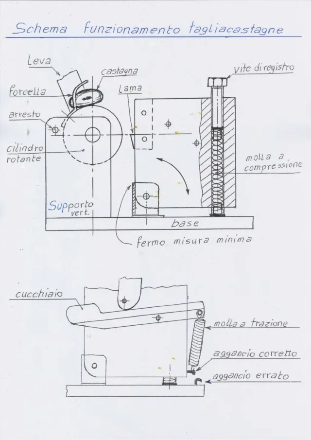

Sincerely, that internal spring you're talking about, I'm sorry, but you had to have x-ray glasses to notice it from those pictures.
I thought it was a adjusting screw for the tilt of the blade.
I probably overestimated your experience and never imagined that you could put a spring for that purpose.
beyond the images, there are the words that describe the operation, but if you do not read, you cannot say that you do not see it, leans below, leans on the base and above there is the screw that records it.
I'm sorry, but I can't see the second traction spring.
I'm curious! Would you please help me understand or find her?
@falonet,the second pull spring is external to the rear end and you see all, including hooks.
Forgive me @marco f inox.
In your first post, you wrote a sermon that, if you author, I went to reread it at a distance of months, you would have difficulty understanding the operation.
to be collaborative things must be clear and as drawings also well you should have placed a simple scheme of operation. (which was also asked to you)
Now. You give me the sacred pleasure of pointing out to me with a nice red circle where this blessed inner spring is located and you also have to explain to me how you understand that it is a spring.
You give me the impression that you want to put people in trouble more than to stimulate them.
@marco f inoxForget the red circle.. Go!
I wanted to give you some more time and I'm pumping up to 814% I found the spring.
Congratulations. you could work for the week of the puzzle or write essays on the gift of synthesis :)

for everyone, I have to make a correction to my description of the operation:
a non was omitted, i.e. the external traction spring should not be bound to the base.. .

as repeatedly requested, allego operating scheme.
for the "castagnata", as I have worked more than all, I will limit myself to bring the tool, then you cut and all drink!

I must be honest, if you had immediately shared the scheme.. I wouldn't have found what you consider the mistake and say it all.. I wouldn't even put the spring inside.
you could reverse the roles and say that in one of the views there is a representation error ..
error is clearly visible 😉
I didn't treat all the hidden lines, but if I did, how could you, make this observation?
