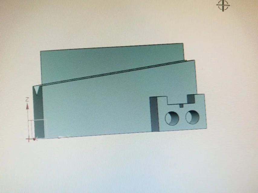

Here I am, I can finally show you the result!
I initially thought of using the sweep command, used by sharp 3d downloaded on the ipad. command that perhaps does not exist in nx
I try to explain:
to create the block with the v bevel I hoped to make two sketches spaced and different heights and then join them with the sweep command.
instead I had to do an extrusion + a subtraction of the second sketch using as carrier a simple line.
I will still make a new discussion for this command because I would be useful in the next exercise of which I anticipate the work done so farIMG_20220329_153959.webp

I can finally show the job done.
I initially thought I would use for the block with the v-cut a command from the sweep name, used in the sharp 3d program that I had downloaded on the ipad.
I would have used it to merge two spaced sketches and with quotated heights to get a finished solid.
I had to opt for a linear extrusion + a bolean subtraction using as a carrier a diagonal line.
this sweep command to join two sketches would be very useful to me for the next exercise of which I anticipate the work done until now and its document.

Well, I'll get you the file I did if you want to compare.
However, what you use is not version 10 and not the update of the 12 you said.
to see the version just go to file>guida> information on nx; You will open a window and there is one among the first lines that tells you the version.
Hi, I'm in the first place with the technical design.
can you understand that the projection is with the method of the 1st angle but the iso symbol of the projection is not wrong?
